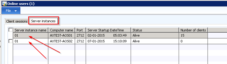

On the tab Server Instances confirm that are are 2 or more AOS-instances connected to the application:

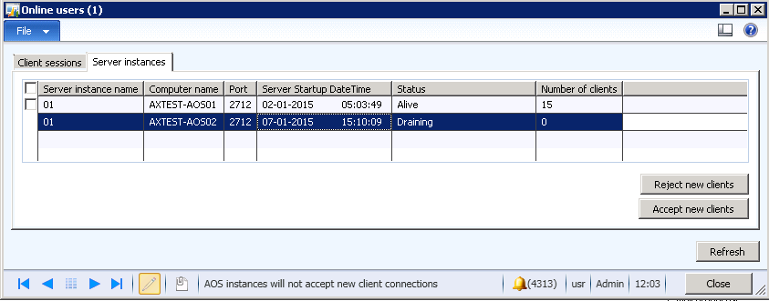

Mark the AOS-instance that you want to redirect from and press the Reject new clients button, e.g.
A prompt will ask for confirmation, press OK:
Status for the AOS instance will shift to Draining, which means that connections to the AOS-instance is in the process of drained from the AOS-instance(s).
To allow connections to the AOS-instance again, navigate to the same form, highlight the redirecting AOS instance and press the “Accept new clients”.
In this way, we have redirected new connections to an AOS-cluster away from a specific AOS-instance, without altering the client configuration.
