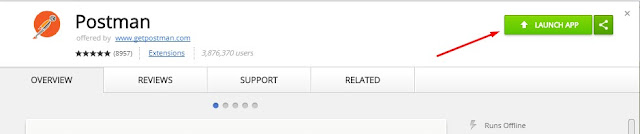

1. Download Google Chrome App "Postman" using this link.
2. Launch App from Google Chrome window.

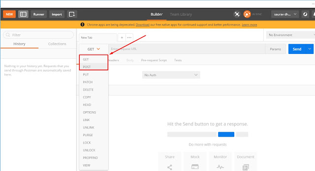

3. Close first popup/splash screen in-app. We can see that there are so many options (15) to choose from. But I was able to find out that NAV API only support 2 options - GET and POST.
GET is used to read data from NAV API.
POST is used to write data in NAV using APIs.

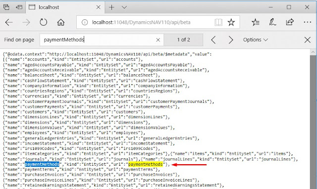

4. I am choosing one of the API from 44 APIs that we see in the last post. Lets select paymentMethods as highlighted below.
Base URL - http://localhost:11048/DynamicsNAV110/api/beta
Name - paymentMethods
So URL To use in POSTMAN - http://localhost:11048/DynamicsNAV11...paymentMethods

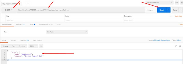

If we choose to post and try to click Send it will not work obviously as it will require some data (at least primary key), as shown below.

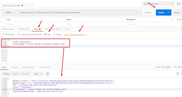

Now I am comfortable with JSON, you can choose other forms based on your comfort and assigned value to - code and description. The code is code in API and Description is displayName in API.
In postman select the Body tab, select raw and you can select any of 7 formats. I will select JSON and enter values for both parameters and then click send.
** Just to remember all these are case sensitive.

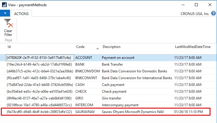

7. Let's check data in NAV table. Here is what we got in NAV using the POST.
