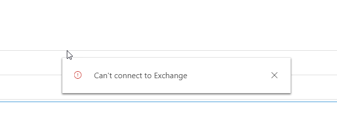

Microsoft also mentioned another common issue that can arise with the Outlook App when using SSS and hybrid connection to an Exchange 2013 onprem. It will show a quick alert saying "Can't connect to Exchange" but it will be able to load the entire Dynamics parts.
This might be caused by the fact, according to Microsoft, that Exchange 2013, doesn't automatically create a self-signed certificate that it can use for communication. Hence this has to be done.
This can be fixed by first creating a self signed certificate and then modify the authorization configuration using instruction found here . Lastly publish the certificate. It can also be a good idea to check that the certificate is still valid and hasn't expired.
