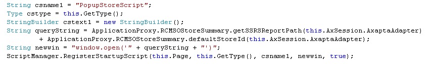

  1. Wrote a dynamic Java Script which queries the Network Path from AX Table
  2. Pass the store parameter to it
  3. Loads the UNC Path dynamically on the fly based on the store parameter
This is the code segment which picks up the Network Path and then dynamically appends the store id to it based on the logged in user's store id profile
Tip: Initially, I was using the ClientScript.RegisterStartupScript method to register the script block but landed into the same issues this bloke was facing when trying to load from webpartzone.
http://stackoverflow.com/questions/6...pt-not-working
, ScriptManager came to my rescue here.

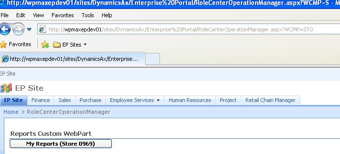

Below is the button in action on our portal Site (Role Center Page) which loads the network Report path
