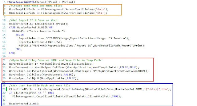

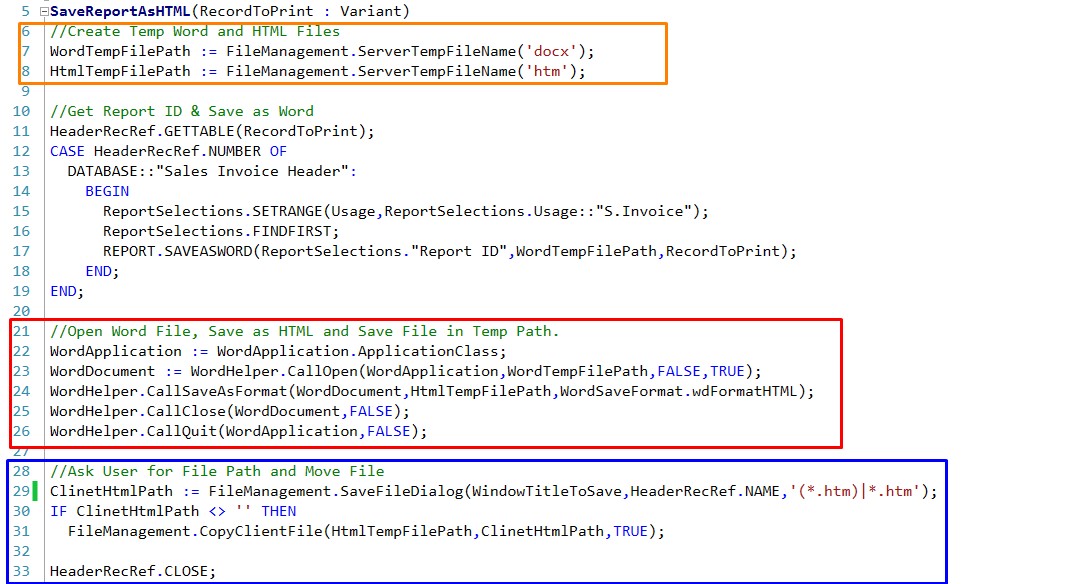

Create a New Function - SaveReportAsHTML which input a Variant Record that needs to be printed.
The Function Creates -
1. Two Temp files of Word and HTML extensions to be used in the process later.
2. Get Report ID using Report selection & Save Report as Word.
3. Open Word File using DOTNET, Save as HTML and Save File in Temp Path.
4. Ask User for File Path and Move File from Temp to the User Defined Path.
Dotnet Variables used in function -
WordApplication - Microsoft.Office.Interop.Word.ApplicationClass.'Microsoft.Office.Interop.Word, Version=15.0.0.0, Culture=neutral, PublicKeyToken=71e9bce111e9429c'
WordDocument - Microsoft.Office.Interop.Word.Document.'Microsoft.Office.Interop.Word, Version=15.0.0.0, Culture=neutral, PublicKeyToken=71e9bce111e9429c'
WordHelper - Microsoft.Dynamics.Nav.Integration.Office.Word.WordHelper.'Microsoft.Dynamics.Nav.Integration.Office, Version=9.0.0.0, Culture=neutral, PublicKeyToken=31bf3856ad364e35'
WordSaveFormat - Microsoft.Office.Interop.Word.WdSaveFormat.'Microsoft.Office.Interop.Word, Version=15.0.0.0, Culture=neutral, PublicKeyToken=71e9bce111e9429c'
All Code used for these four tasks is below.

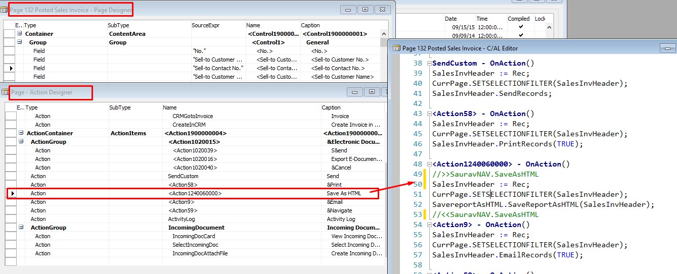

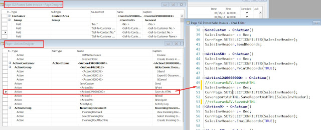

Almost Done. Let's do calling from Sales Invoice Page.
Add an action in Page and Call the function that we wrote above, as shown below.

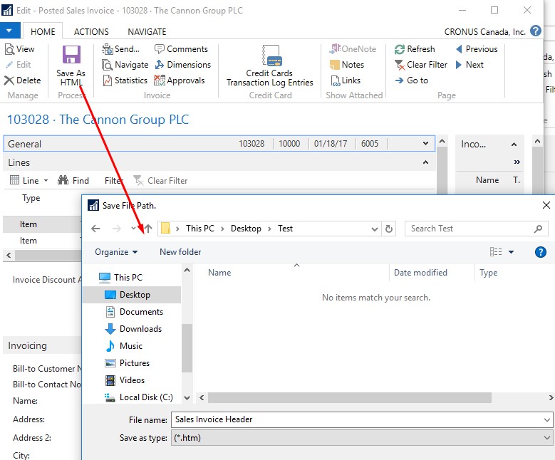

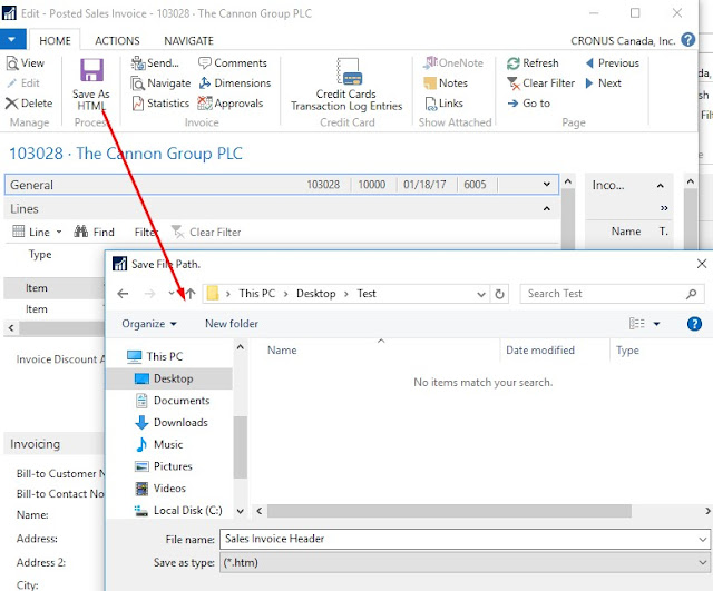

Let's Run.
