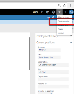

As the following picture shows, the Task Recorder is found under Settings: in the ribbon:

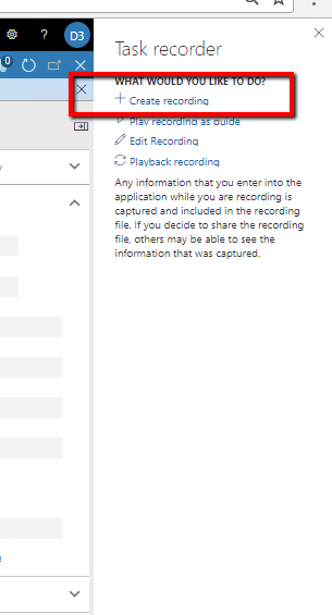

Once in the Task Recorder, you have the options to create a new recording, play back a recording or edit an existing recording as the following picture show.
Let us start by recording a new Task.
Give the guide a descriptive name and press the Start button.

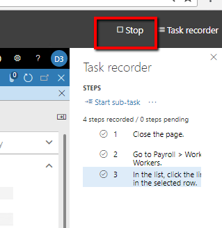

The task recorder is now in recording mode. You can stop the recording by clicking on the Stop button in the ribbon.
I would like to structure my Task Guide in sections, so I start my creating a sub-task:

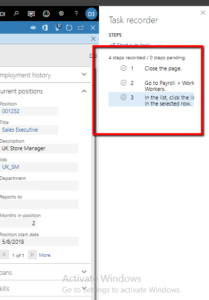

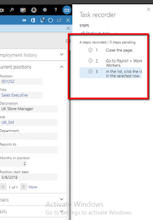

In my demo i am performing some action and you can check in the screen shot Task recorder is recording every steps.
Like
1st I closed a open page
2nd open Worker from payroll
Step-1
Step-2
Step-3 Stop

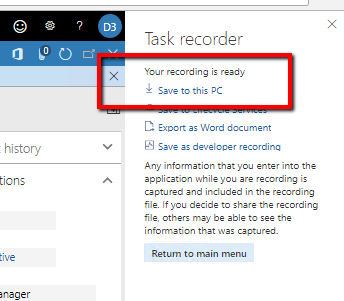

There are two options available to save record.
Word documentation
Save file in AXtr format.
