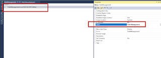

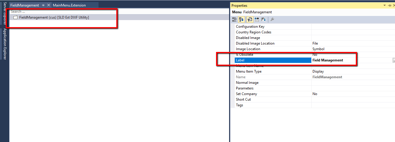

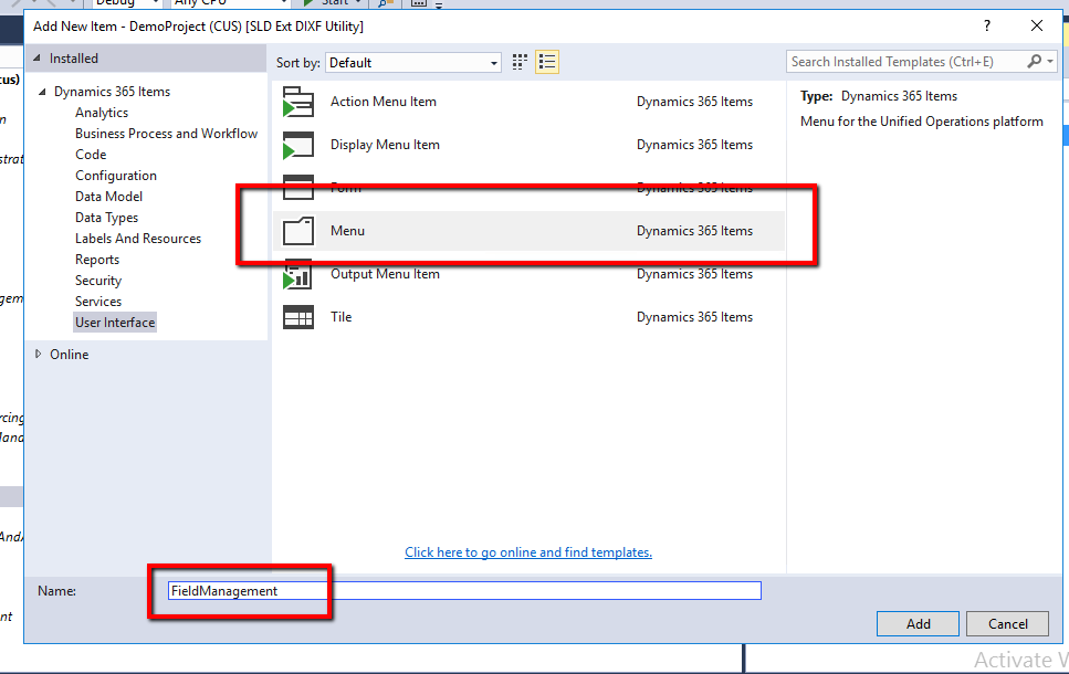

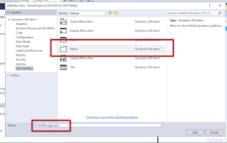

Step-2 Create new Menu and add two sub menu in it. enter label as per your requirement.
In demo I Use Name of new menu as FieldManagement
Reference screenshot:
Set Label
Add new Sub-Menu

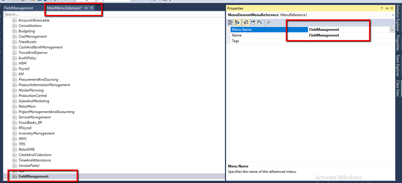

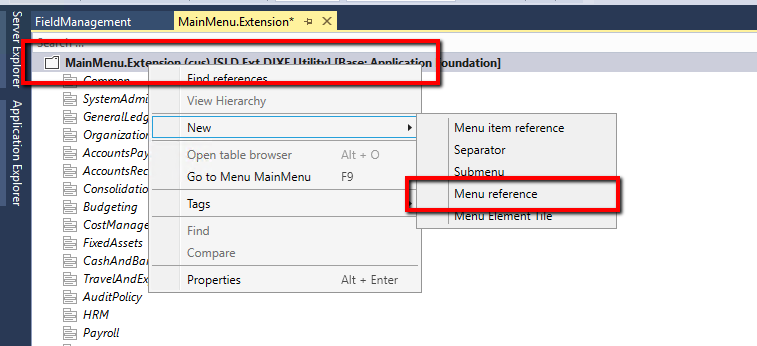

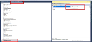

Step-3 Create Menu reference in MainMenu Extension and set the reference of FieldManagement.
Set reference of FieldManagement

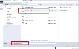

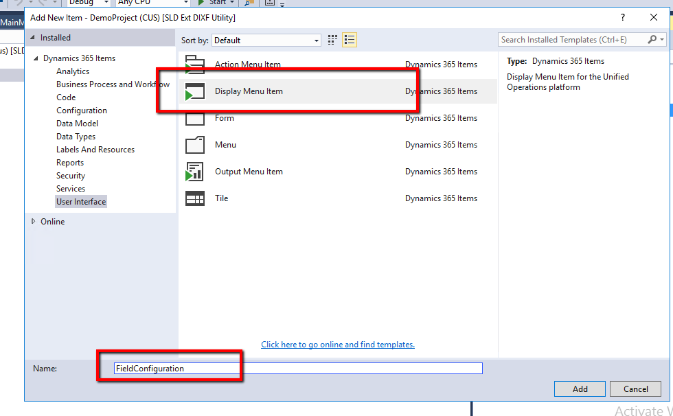

Step-4 Create Display method or Action or Out-Put as per your requirement.
set proper label and make it part of your sub-Menu of FieldManagement.
In demo we used display method
Set Display menu
