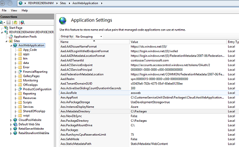

The website contains parameters for DB connection and for binary directory with business logic and metadata. You may find them in website’s Application Settings along with lots of other interesting parameters.

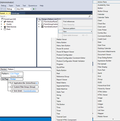

This is an important innovation to forms development – strict patterns that you must follow in order to compile your form. IDE gives a nice tree-arranged details on the expected form structure that must adhere to the chosen pattern. Some patterns resemble those in AX 2012 but there many more.
Additionally, some controls like Groups may have their own subpatterns that depend on the parent form's pattern.

Standard controls
The list of standard controls currently available is quite impressive, however the documentation is scarce for most of them. However it may give you an idea of the UI development capabilities provided out of the box.
