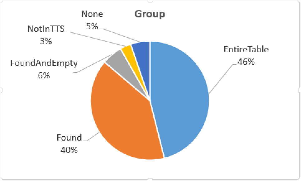

TableGroup Group
The suggested CacheLookup value is Found. Actually more tables have EntireTable value and together with Found it makes 86% of all Group tables.

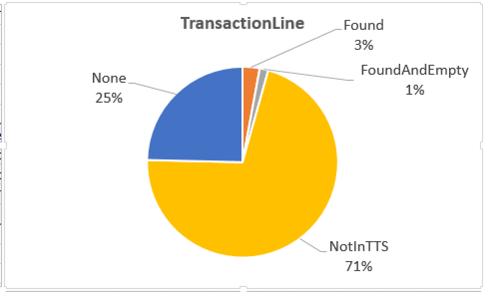

TableGroup TransactionLine
The suggested and actual values are the same - NotInTTS. 25% of tables or 17 tables have None.

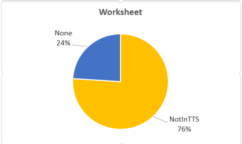

TableGroup Worksheet
The suggested and actual values are the same - NotInTTS. 24% of Worksheet tables or 24 tables have None.
