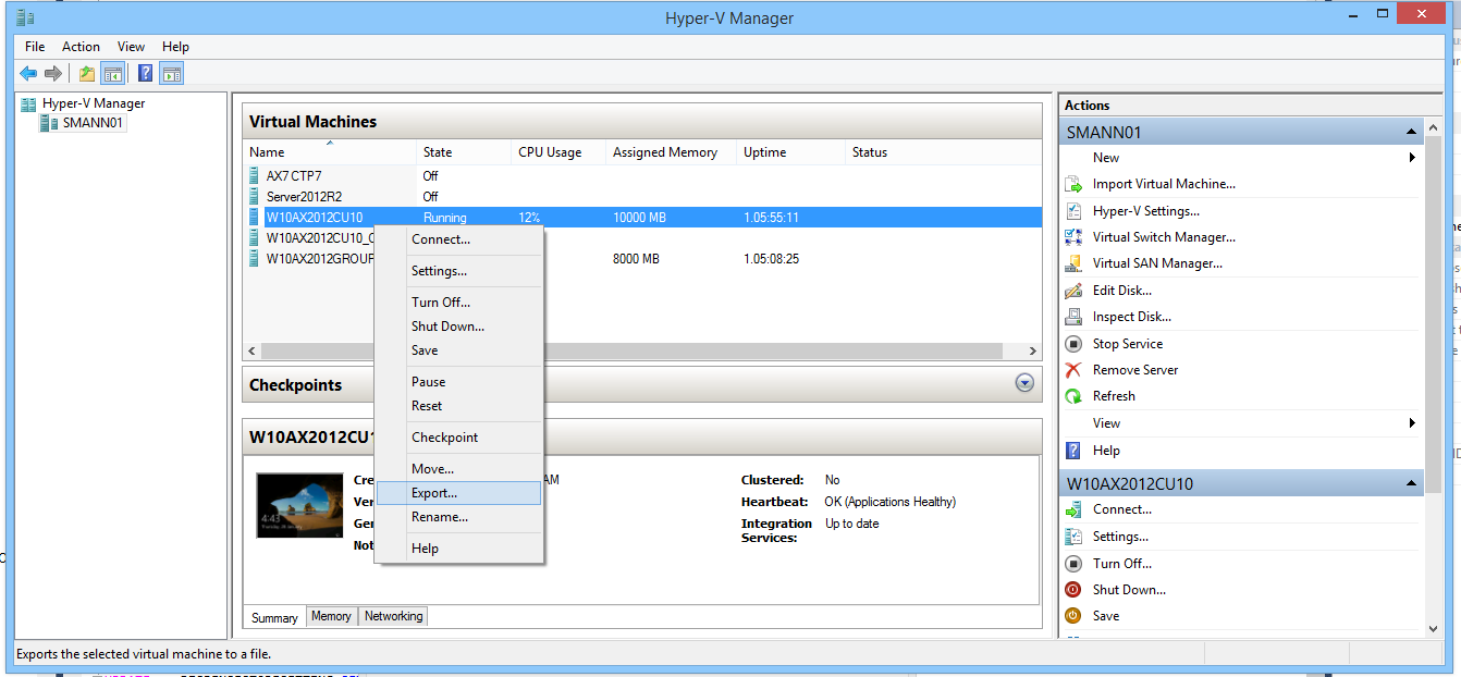

Right click on the machine that you want to clone and click "Export..."  This can be done while the machine is still running and will export a vhd of the machine in its current state.  Choose the folder to expert to and click export.

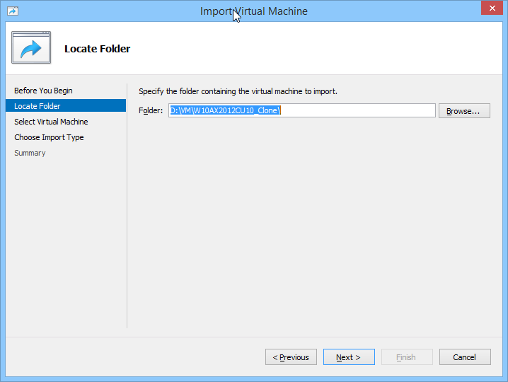

Right click the host computer in the left hand pane and click import virtual machine.  Choose the location of the vhd that was exported in the last step.

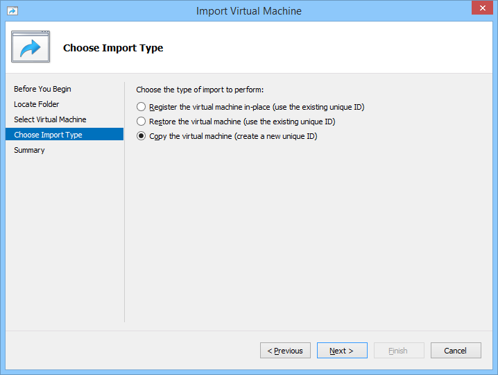

Choose to copy the virtual machine, creating a new ID.

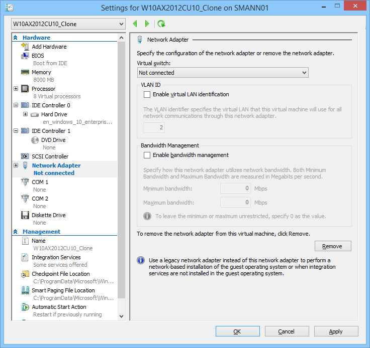

Important.. Before starting the new VM make sure todisable the network adaptorfor it.  If the machine is started with the network adaptor connected then it will authenticate with the domain controller with the original computer name, this can cause the original VM to be unable to connect to the domain again.  The message will be something like "The trust relationship between this workstation and the primary domain failed"

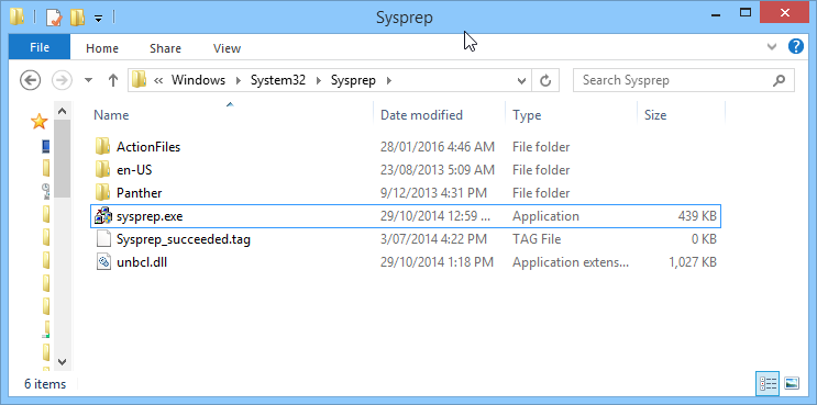

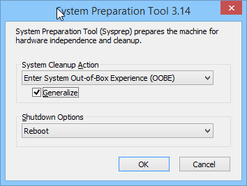

Once the cloned machine is started, in system properties change the computer name, then run the SysPrep utility.

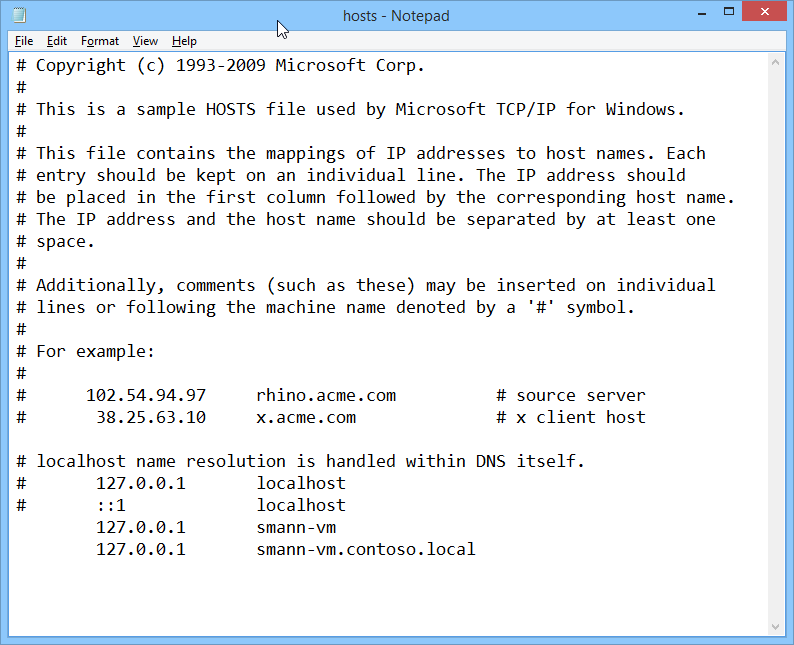

Open the host file from C:\Windows\System32\drivers\etc\hosts
Add two entries to this file, one with the original computer name (not the new computer name), and one with the original machines domain name.
Once this is done then the AOS should start fine, client will be able to connect without any configuration changes, retail async and realtime services will work with existing certificate.
