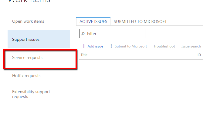

Step-1 Click on hamburger Icon and click on support menu item.
Step-2 Now click on Service request tab from left panel.

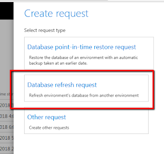

Step-3 Now click on Add icon a popup window will appear with 3 Different Request.

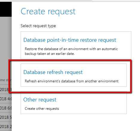

Step-4 Three type of service request available. Please click on Database Refresh Request.
Following are some information about service request.
Data Point in time restore request
This request we use to request Microsoft to restore the production DB on any particular date.
Other Request
In this service request we can ask for different options, Like ICM ticket or can request them to update the statistics of production database.
This service request we use to restore database from production to UAT.

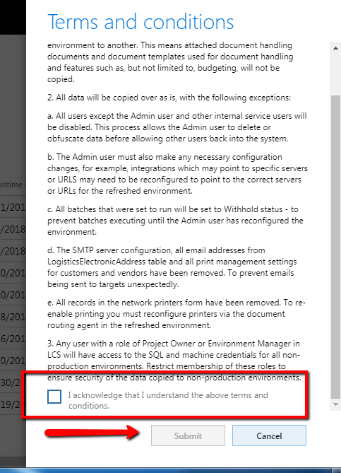

Step-6 Mark check box to acknowledge the terms and conditions and click submit.
You request submitted to Microsoft.
