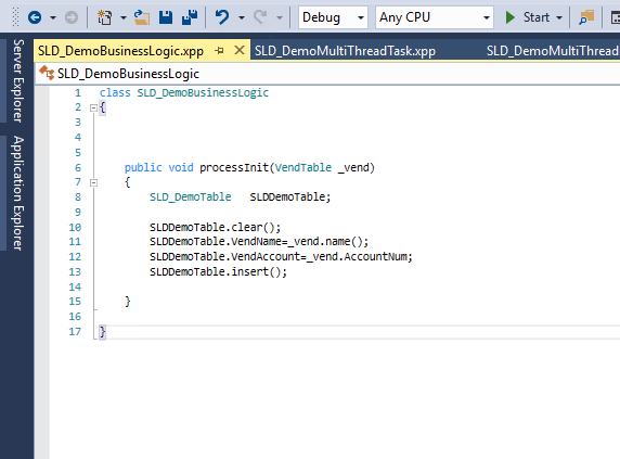

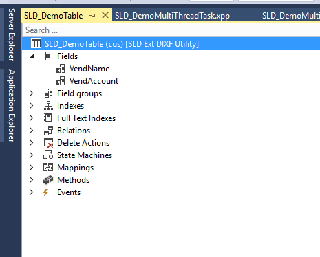

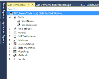

Step-1 Create a table for demo purpose in our demo we keep table name is SLD_DemoTable.

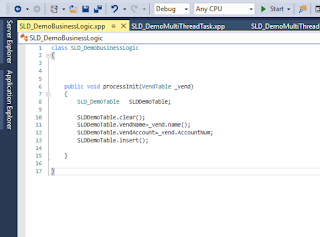

Step-2 create a class with name SLD_DemoBusinessLogic and write your business logic in this class.
In demo I write only insert records in table and show you guys how it works.
Reference Code
class SLD_DemoBusinessLogic
public void processInit(VendTable _vend)
SLD_DemoTable SLDDemoTable;
SLDDemoTable.clear();
SLDDemoTable.VendName=_vend.name();
SLDDemoTable.VendAccount=_vend.AccountNum;
SLDDemoTable.insert();

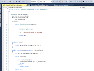

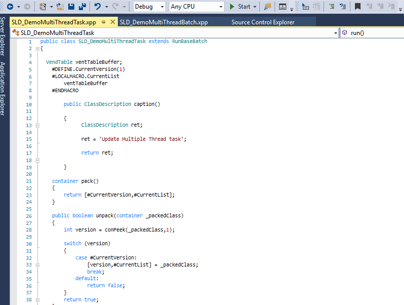

Step-3 create a batch job class with name SLD_DemoMultiThreadTask.
This class we will use as Task in main batch job.
Step-4 In this class We Create a getter setter to store vend table buffer;
Step-5 Create object of our business logic class and execute method
Reference Code
public class SLD_DemoMultiThreadTask extends RunBaseBatch
VendTable ventTableBuffer;
#DEFINE.CurrentVersion(1)
#LOCALMACRO.CurrentList
ventTableBuffer
#ENDMACRO
public ClassDescription caption()
ClassDescription ret;
ret = 'Update Multiple Thread task';
return ret;
container pack()
return [#CurrentVersion,#CurrentList];
public boolean unpack(container _packedClass)
int version = conPeek(_packedClass,1);
switch (version)
case #CurrentVersion:
[version,#CurrentList] = _packedClass;
break;
default:
return false;
return true;
public void pramVendBuffer(VendTable _vend)
ventTableBuffer=_vend;
public void run()
try
SLD_DemoBusinessLogic SLDDemoBusinessLogic=new SLD_DemoBusinessLogic();
SLDDemoBusinessLogic.processInit(ventTableBuffer);
catch
info(strFmt("%1",xSession::xppCallStack()));

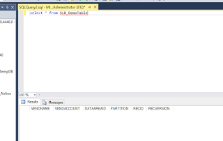

Step-10 before execution of the batch job check the demo table.
you can check the below screen shot currently table is empty.
After execution of the job table filled with vendors names.
