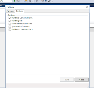

Synchronization after build of packages
There is option available to sync database with build model feature, In this option DB with start sync after build of the model...
Navigation
Go To > Dynamics 365 > Build model
Now select model/models then click on 2nd tab and Mark checkbox of synchronized database.

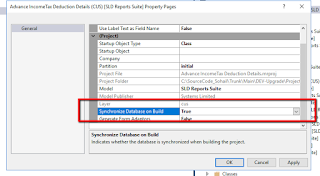

DB sync on project build
The properties of a project in Solution Explorer, there is property available synchronized database of every build of project
